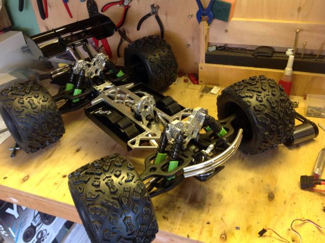

Sooooo.. Progress on my build..still waiting on front dogbone as unfortunately the Associated one was just a hair too short
Going with RPM bulks and stock diffs for the moment due to budgetary constraints (she who must be obeyed )
Should be ok as plan to start with 4s while I get to know the beast..
Had to put her in roller just to see those Big Joe 2 badboys
