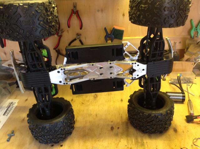

I think around a 14t is a good starting point, assuming you have 1/8 diffs? This gets you into the low 40mph range on 4s - I would use smaller pinion on 6s, or a lower Kv motor.

Going with Stock diffs to start as I have a meet in two weeks Mike..suggestions please? Scriptasylum says WAY to High speed if I have the numbers right ?
