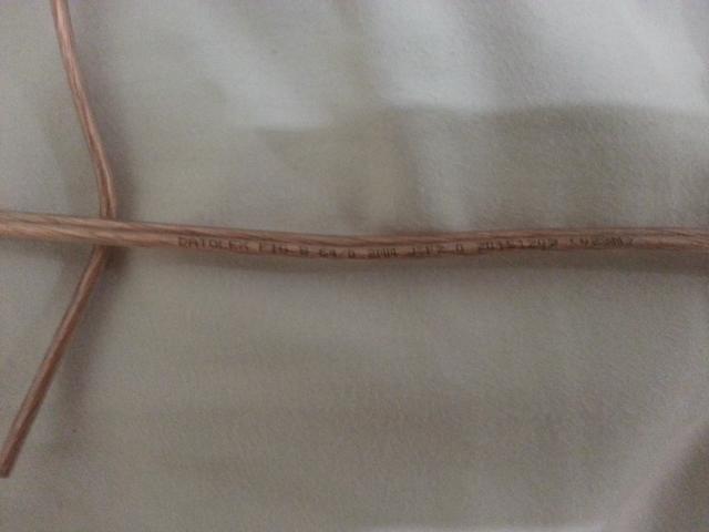

I think it's Fig 8 cable.

I would not do that, Maybe if you dubble it up, so two to three lengths per pole.
Personally I would use 10 gauge or bigger.
Which awg is on the charger?

There using 14 gauge for the input leads/aligator clips.

Ok, but longer cables equal more losses.
I would double the wire up to try, but keep an eye on the temps!
