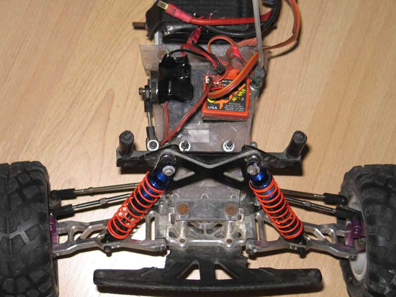

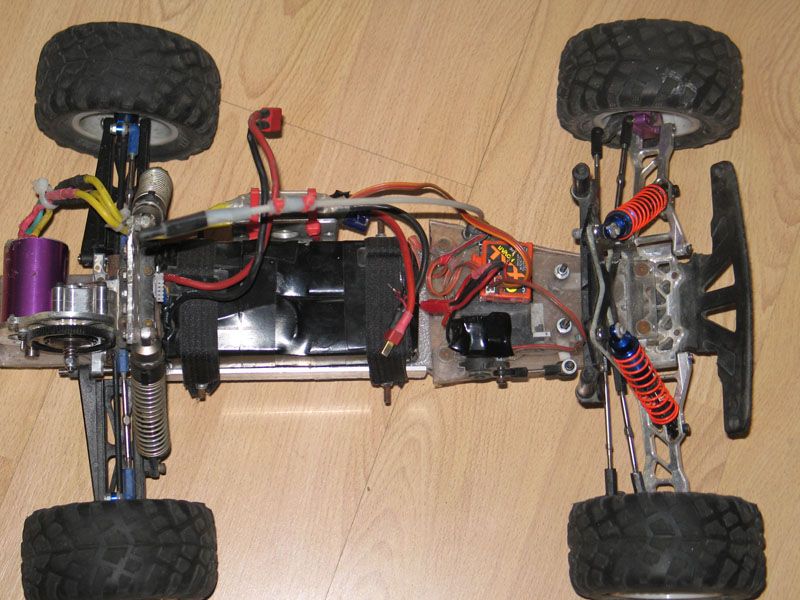

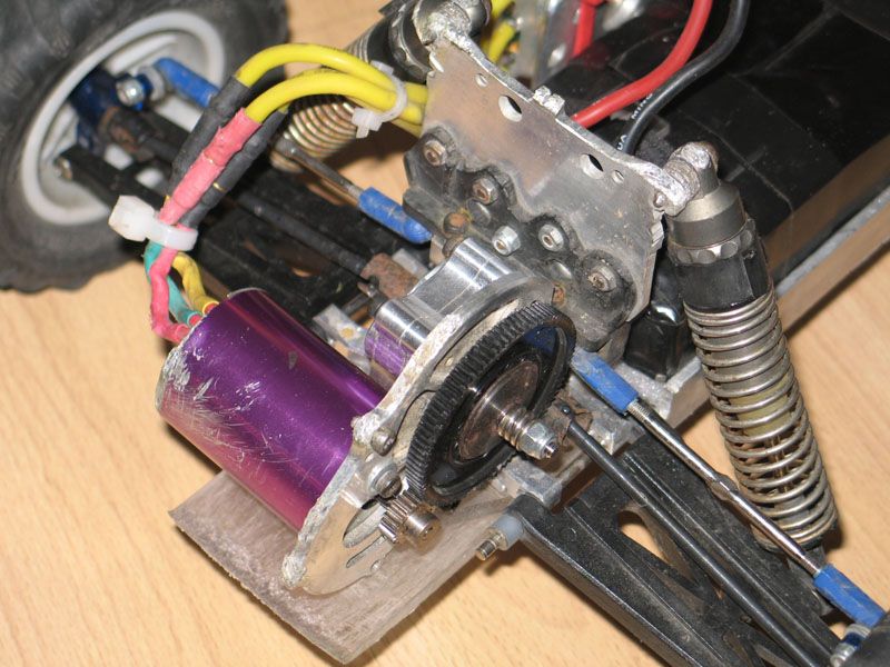

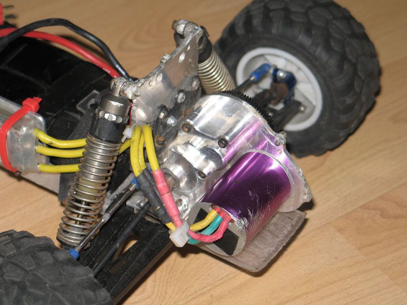

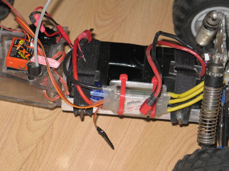

My Rustler has:
-Nitro Rustler front spindle/block conversion with aluminum carriers
-FLM extended front arms
-RPM wide bumper
-fiberglass shock tower (cracked the CF one)
-Duratrax Overdrive ST shocks with soft springs and 30wt. oil
-FLM front bulkhead
-custom chassis from 1/4" polycarbonate with aluminum angle pieces for stiffening and battery holding (need to put a brace from upper deck to angle pieces)
-Blue Bird BMS-620mg servo
-Electric Power 4s 5400mah 8C Lipo battery custom modified to fit the chassis (also use this battery in my 1/8 buggy)
-Ofna 1/8 Super Shocks in the rear (VERY nice)
-cut up stock shock tower on custom aluminum tower (needs replacing)
-FLM aluminum gearbox (I've scraped the crap out of it!)
-aluminum idler, steel top gear, stock differential
-Feigao 540 12s (loose front enbell) with MGM Compro 12012 and a XUS Hobby UBEC
-HPI Yokohoma tires on Traxxas lightweight wheels

MetalMan where did you get those aluminum carriers?
MetalMan
MetalMan's Avatar
Posts: 5,297
04.14.2006, 01:10 PM
The front aluminum carriers are these:
http://www2.towerhobbies.com/cgi-bin...?&I=LXSK19&P=7
They are for the Nitro Rustler, which uses a different wheel setup, where the bearings go into the wheels (like Associated and Losi). I forgot to mention that I am also using aluminum rear axle carriers:
http://www2.towerhobbies.com/cgi-bin...?&I=LXMW88&P=7
