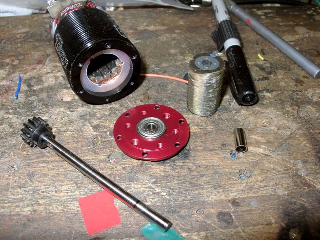

Originally Posted by Electric Dave View Post
Shark, did you re-tap for 4mm? How did that go being unable to take the front part off?
Dave, first I DO NOT RECOMMEND THAT ANYONE RETAPS THEIR MOTORS. The risk to damaging the motor/coils is very high (there is only a few mm of clearence from the endbell to the coils). And that's why I didn't mention in my post. It is much safer to send it to Neu and have them re-tap or exchange for a m4 can. But that being said I just could not sleep seeing that huge motor held on by two tiny m3 screws, I had several motors loosen up (slip) a few times and I think it could be related to the m3 screws that stretch or the small heads dig into the mount causing the looseness. For the m4 screws I used a mill to drill the holes, with the mill you can set it to only travel a specfic amount, so I measured the depth of the holes and ensured I was well short of the coils. You have to take the motor apart so you can clean out the metal chips. I used a special tap (blind hole) that allows you to tap in a very shallow hole, normal taps have a starter point and they need to be feed deeper into the hole, which could hit the coils. When cleaning out the can I was careful not to blow out the bearing grease/oil, nothing kills a bearing faster than lack of lube.

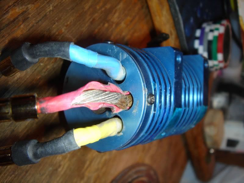

Update:
I was cleaning/checking the buggy out when I noticed the shrink wrap on my motor wires looked strange. I took a closer look and the middle wires shrink wrap had split and was bascially falling off. It does not appear to have shorted because there were no burn marks on the endbell cover or wires and the buggy ran fine this weekend. I took off the rear endbell cover, added two layers of new shrink wrap and bolted the endbell back on. There is still a little gap between the wires and the holes in the endbell that can cause friction wear on the wires so I filled the gaps with hotglue. The hotglue also provides a better dust seal.

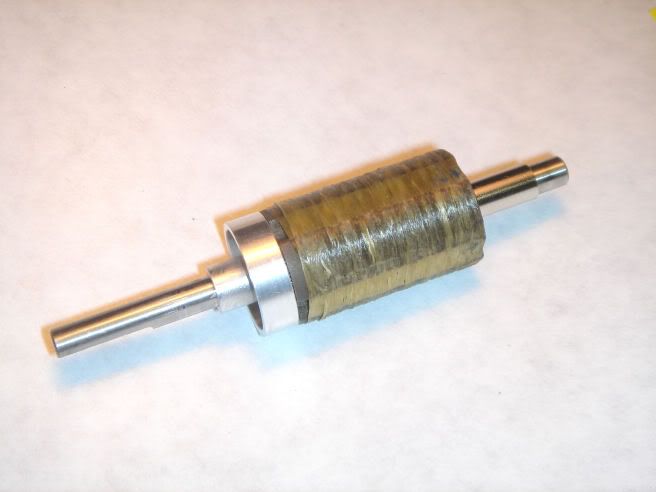

Hi, regarding the Tekin motor. I am running them in my buggy and truggy. The buggy separated a magnet on the first pack, Tekin customer support got me a replacement within the week and it has about 6 packs thru it with no issues. The truggy motor has been going strong since day one (about 12 packs). Both motors perform well, are very strong, and temps are good. The 3mm/4mm mounting holes are a great feature (I use the Losi mount with 4mm screws). I have been running them with a MMM ESC and this combo works fine.
Separated magnet
New replacement rotor

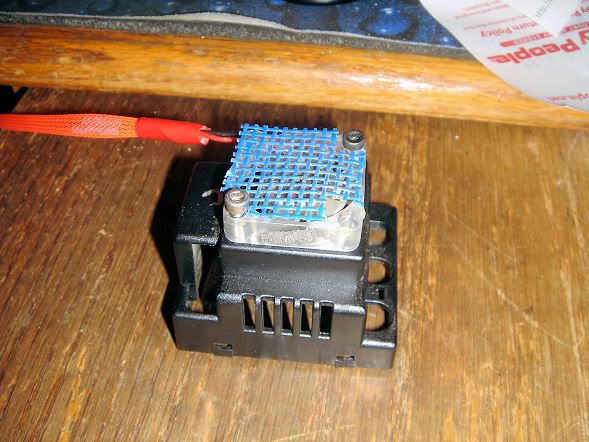

Been a while so I thought I would pass on some updated info. Still super hot at the local track recently, air temps 106+ and ground temps 140 degrees. So I got some extended run time in during the day to see how the electronics would hold up. The Tekin T8 and MMM motors held up great and temps were decent (never got hotter than 175 degrees). My MMM ESC handled the heat fine, but I did have a problem with the fan, it was working intermittently. I always check to see if it is working when I first turn on the ESC and the fan was not moving. I removed the fan and tested it and it was indeed dead. I have several MMM ESC's and this is about the 3rd fan failure. It is a pain to remove the ESC, take the case apart and remove the fan, so I decided to make it a little easier. I don't recommend you do this because it could void your warranty, but I bascially attached the fan to the outside of the case and ran the wires directly to my rx so the fan was on all the time. This setup allows quick replacement of a broken fan, you can tell right away if the fan is dead and it runs all the time, which keeps the ESC cooler. Just drilled two holes and used two 3mm screws to hold the fan down.
