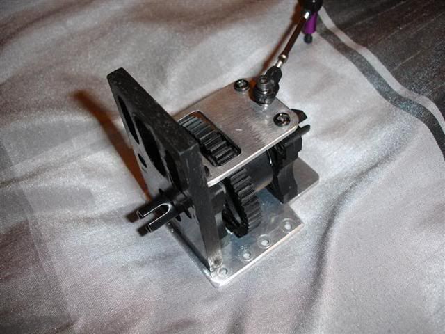

im thinking about making a custom centre differential unit for my G3 chassis. Could you guys please point me in the right direction of what the best diff to use is. I was looking at the OFNA spider centre diff or something from Xray. I'll need the spur to be mod1 pitch as well, so it can work with all the pinions i already have.
Can anyone post some links to some designs for a CD as well, as i'm not too sure how to make it, i was thinking of just modding a CD assembly from a nitro to fit. Or make one along the lines of this, only alot better...

the spider diff has 6 mounting screws, and the kyosho spur wont fit, it has 4. The spider diff has 46 or 48, and I believe IIRC a 52 tooth version, if you're worried about metal to metal wear it's not that big of a deal with mikes hardened pinions. Check out Mikes custom direct drive unit in the thread RC monster direct drive unit in the customer testimonial and feedback section, I bought oneand a 46 tooth spider diff I'm going to tun in an flm e-maxx. It's just like the center diff you pictured, but all aluminum and very sturdy. It is designed for an flm chassis, but as I stated, it's just like the one you pictured, and could easily be mounted on a gorillamaxx chassis.

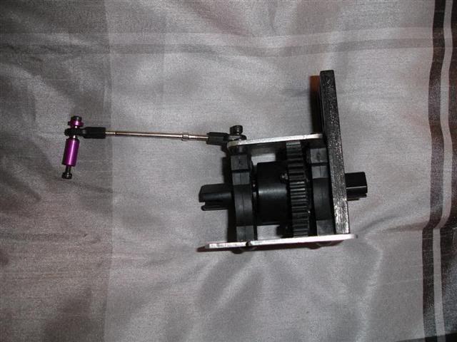

At the moment i'm going to go with a similar design to its me's CD setup in his project (see, muggy diff thread in the t/e maxx section), using the stock motor mount plate. I'll probably fit the Gmaxx single motor mount i have now, have some Al. braces OFNA or Xray, and cut 3mm CF top and bottom plates.

thanks its me, hope you don't mind me ripping off your design Its one of the best i've seen so far

and no I dont think so HB was its own company long before HPI owned it, I bet it wouldn't hurt to try if you have a cup lying around?
