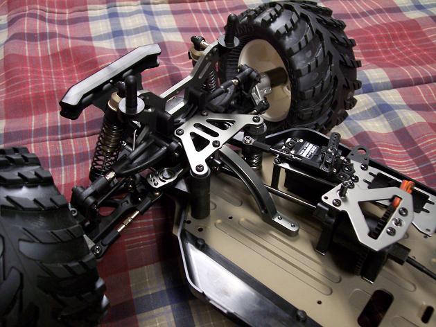

I have the GS racing SUT CE sitting here ready to go silent. I removed the brakes and all the nitro stuff. i have my motor mount templates drawn out, it will be a front and rear supported cradle mount using one of Mike's XL size heatsink clamps (like i did in my ls10), so far i have bought or ordered the following from fellow members or from the RCM store;
-5s 5000mah flightpower lipo
-10xl bk wanderer motor
-tmaxx reciver box
- hitec 5645 ditigal servo
-XL rcm heatsink
-mike's battery tray kit for the flightpower
- another cc bec
-ofna molded inserts
-13,14,and 15 tooth pinions
this weekend i will pick up some tires and wheels since i kinda got jipped on the sut ce coming withOUT bowties, i havent decided on wether to go with crime fighters, or bowties yet. I plan on running the mamba monster max controller as soon as they get the first batches problems fixed and shipped back out.
thursday i will have the day off and will be going back to the college for the day and will make my motor mount after i get done helping the instuctor with our PSI tug they bought and finally got running.
after i get the motor mount done ill just be waiting on everything being shipped, and i guess ill still be waiting on the MMM also, hopefully they get these fixed quick and a bunch more shipped out.
any suggestions on a body???, no crowdpleazers, i dont really wanna run the stocker since is was a #'d special edtion truck so i was thinking of keeping it and the keychain and jsut putting them up for keeps.

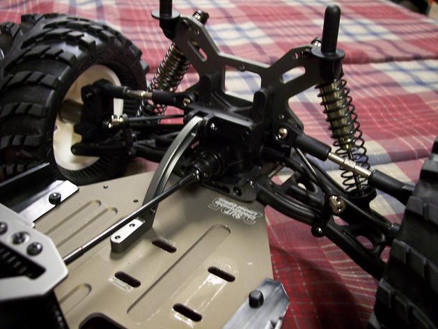

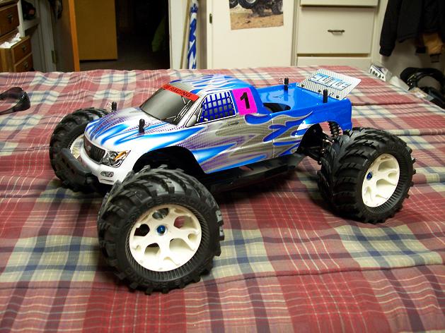

notice the 5mm drag link, cnc front and rear braces, all 4 toe blocks are machined, the 4mm towers, full cvds, all ballbearing steering (no bushings anywhere), front and rear swaybars, and of course in this picture its hard to miss the hardanodized and milled out special edition 7075 chassis. (and a feature you cant see in the spiral cut ring and pinions on the diffs)
this was definetly the truck to have back in early 05 when it was released. hopefully with some decent driving and the 5s setup ill be able to put it on top of the local tracks truggy class.

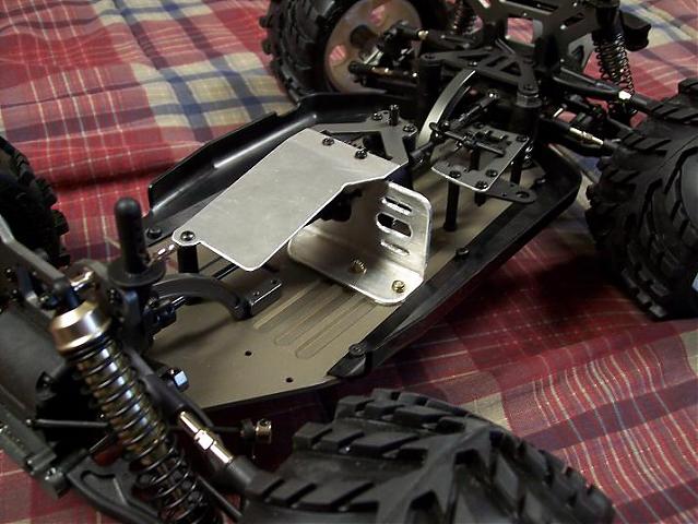

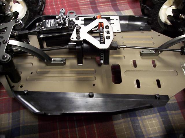

here is the front part of the motor mount and the esc mount, the back part of the motor mount istn pictured because it will bolt to mike heatsink clamp when ever i can get one. (motor mount is made out of .100 7075 t6, while the esc mount is .050 6061 t4)
the esc mount plat has a flat part 2x3" and should be big enough to hold the mamba monster and a CC bec and the on off switch.
btw all this bolted to existing holes inthe chassis, and so will mikes battery tray, so its been alot easier then drilling and taping a bunch of holes like i did on the Ls10
what do yall think?

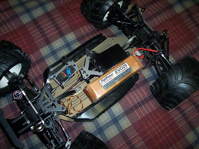

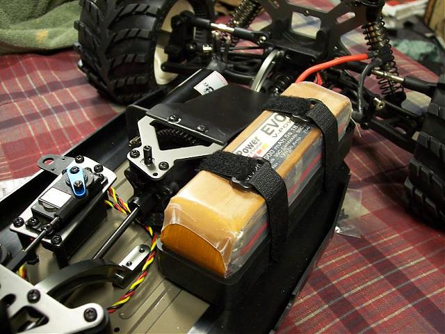

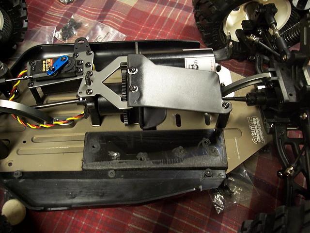

finished it up today,

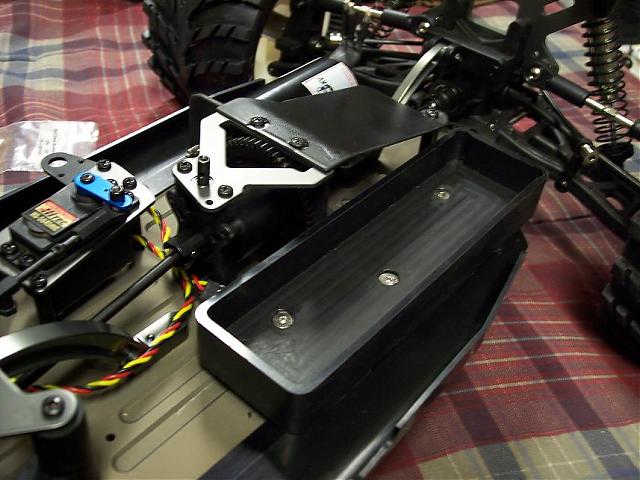

got mikes battery tray mounted, the flightpower fits PERFECT, i dremeled out a small channel where its next to the spur and its as close to the middle as possible.

jnev
jnev's Avatar
Posts: 2,864
06.02.2008, 11:29 PM
Looks great! What material did you use on the piece coming off of the center diff?
Looking forward to some more FMX ramp action with your rc's.

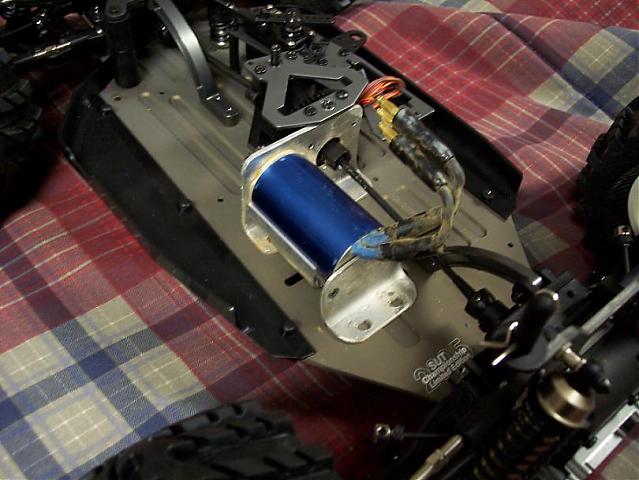

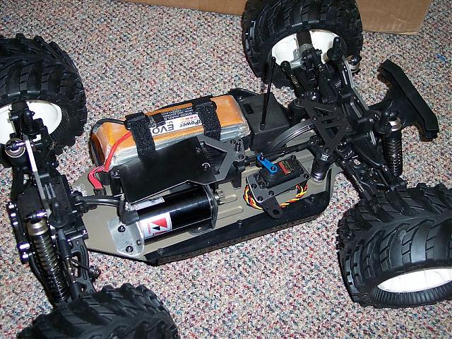

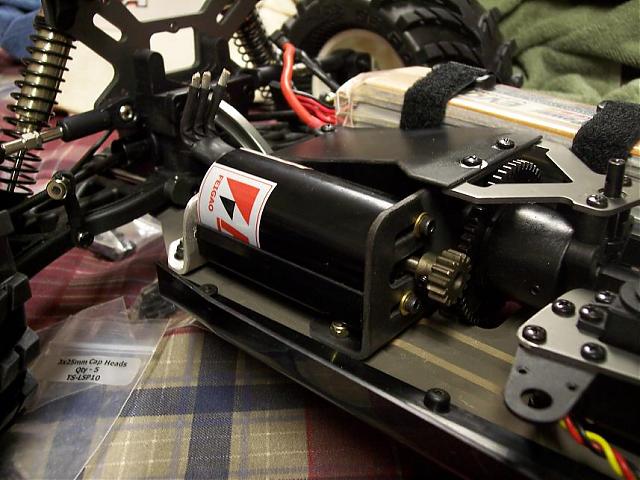

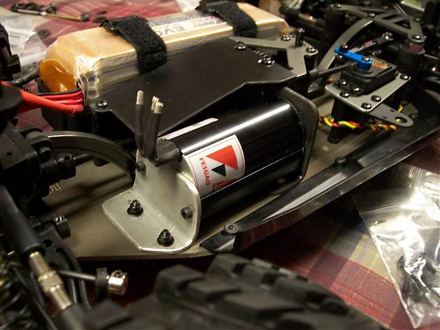

here is the cradle motor mount i changed my desigin so that the rc-monster heatsink / cradle sits all the way down on the chassis, its also clamped and supported in the rear and i still have to paint the rear support black to match everything else.
very solid
also im glad the 10xl came in black to go along with everything else i was dreading having a purple motor stick out like a sorethumb, guess i got lucky or is that a thank you mike?

Here she is all finished up, as is with the big honkin MT tires, and no esc im at 9.1 pounds, is that heavy or light? or normal for a 5s setup? im geared 14/54 and once i drop the extra weight of the mt treads for some LPRs or komodo LPs ill have it geard for about 37ish with a 6% loss.
you can also see the tmaxx reciver box in the photo (thanks bl-revo)
i think it turned out good and clean now just gotta paint that back half of the motor mount to match and get an ESC.
plans with the low gearing is for 25 min runtimes and cooler esc, hopefully itll be under 9 pounds rtr with the MUCH lighter tires and the esc installed, oh and i gotta put my wing mounts and wing on off the storm buggy when they come in.
well howd i do for my first "nice" build ?

Dafni
Dafni's Avatar
Posts: 2,487
06.03.2008, 03:52 AM
Nice, but you should not use the motor as chassis brace.
Your chassis will flex, and with the motor like that, you' re asking for trouble.
Daf
