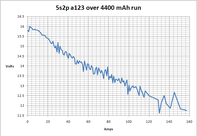

This might help you. It shows my 5s2p a123 pack over a 4400mAh run in my E-maxx. The pack started at 16V because it wasn't fully charged.
You're looking at the average voltage drop for each Amp unit.
20A, it dropped from 16V to about 15.4V.
30A, it dropped from 16V to about 14.8V.
I hope it helps.
