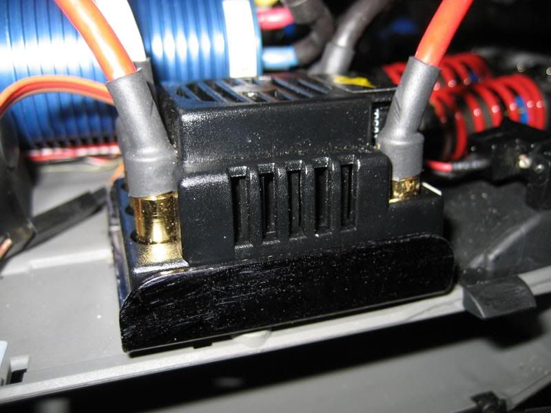

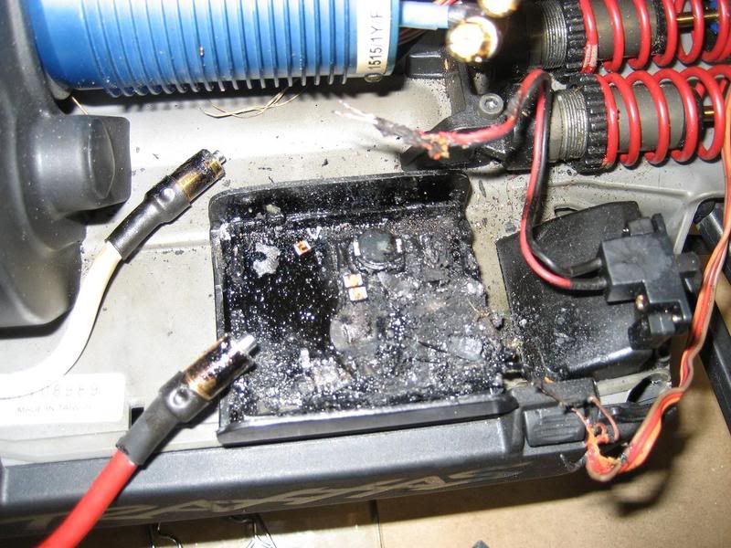

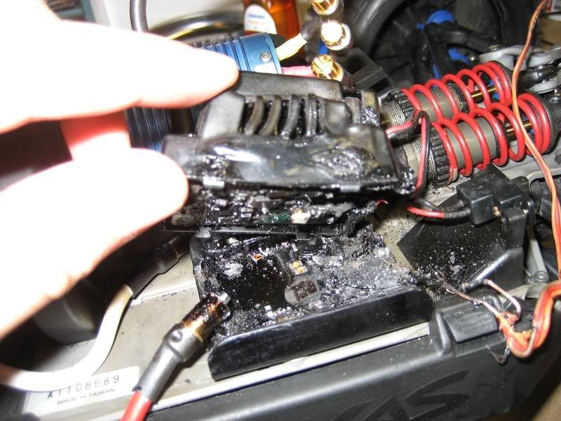

09.08.2008, 03:13 AM
I used a piece of scrap aluminum.
I bent it and painted it (with a sharpie)
I used one of the origional holes in the chassis to mount the plate and drilled a new one as well.
once the plate was secure, I double side taped and zip-tied the MMM to it.
as it turns out, it wasnt a bad idea
waiting for mt MMM V2.2
at least I didnt melt the plastic chassis...

09.08.2008, 05:48 PM
That's crazy Hoov. Looks like the mounting plate did it's job well, though. Great job on the construction and I may do the same thing.
I'm using one of these:
There are actually 2 screw holes in the chassis where the inside screw went for the EVX, so I have a button head on the outside edge and a flat topped screw on the inside of one of the adjustment slots. Stays put rather well with the MM and should handle the v2.2 once it's here.
Hope mine doesn't melt down. :(
That happen with 4 or 6S, Hoovartid?

09.08.2008, 10:39 PM
Originally Posted by J3110 View Post
That's crazy Hoov. Looks like the mounting plate did it's job well, though. That happen with 4 or 6S, Hoovartid?
I was running 6s at the time.
I use the TRC 2s 15c 8000's for my 4s set-up
The zippy 3s 4300 20-30c for my 6s.
