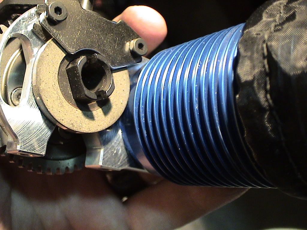

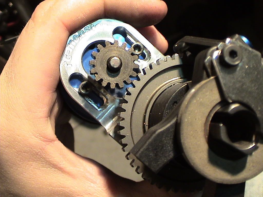

i am trying to setup mech. brakes on my RCM RC8t and the motor can rubs up against the brake discs before the spur and pinion can engage. is there a solution to this that i am not seeing?

take a dremel to the brake disk?

if you use 50T spur you can get 54t one which will give you 2mm more and if that is not enough get larger pinion.

i thought of doing that but i would have to dremel quite a bit to make it work and already there is only 3/16" of the disc that touches the pads. if i dremeled it i would lose alot, if not all, of my stopping power.
i also considered changing to larger gears. the gearing on there is 16/50 and i would have to use probably a 17/54 or even 18/54 to get it to work and that is not gearing that i want to use.

Thats not what the brake spacer Mike makes looks like, I have one, its like a 3/4 moon cut out to miss the brake. its not the full spacer in the pic

this is the one. i drilled and pressed in two bearings when i was using it. using the motor brakes now.

The brake version is cut out to provide clearance for the discs - It works... Trust mike...

Yeah thats pretty much what Mikes brake spacer looks like

You could also dremel the motor fins if there is any room to do so.
