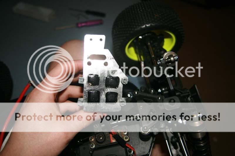

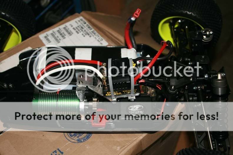

So, the mount, although it looks big, weighs a bit less than the "normal" one that everyone uses which flips the diff around the other way and raises it with the spacer. Took me 2 days to mill and I am not quite happy with it. I could have lowered the motor .100" and still had good clearence for the chassis to flex and the pinion to clear. I will probably make a new one later but I used the last of my 1/2" plate.
The battery is a "quick change" thing (I havent finished the latch though so no pic of that yet) so the battery stays with the battery tray, it just slides on and locks into place on the chassis. It is elevated slightly off the chassis so as not to inhibit the chassis from flexing. Total weight is 9.05 lbs and I could trim a bit of fat still from the battery tray and the mount if I want to. Should be about max 9 flat after body and paint and the fat reduction.

This is the motor mount, you can see how much is shaved off.
Next 2 are the batter mount setup. The battery stays with the tray, the tray slides onto those "T" slots from the rear and locks in with a spring loaded pin from the top (not made yet).
Bottom side of the monster mount. I got lazy but I could trim alot of excess material off of this thing and loose a couple grams.
