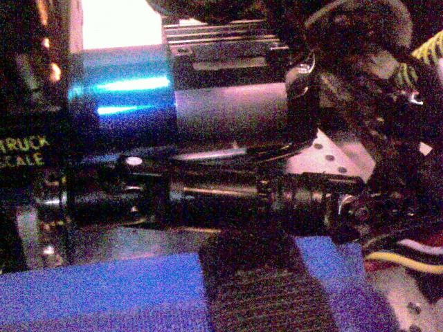

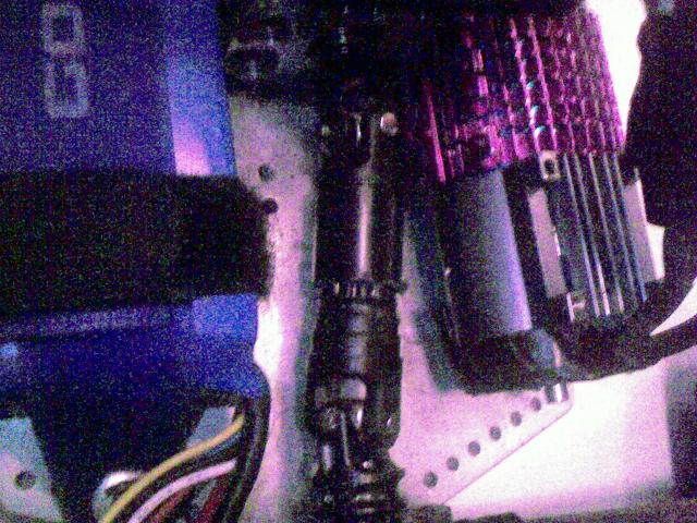

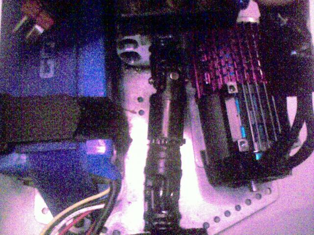

aahh finally solved my rear driveshaft issues , i fitted the revo driveshaft on it , and its the first time i go through a whole battery without stopping and fixing something, if anyone want to know how to do it , tell me and ill make a how to thread

What are you running in the .5 to break driveshafts?
I've run 1400W pushing M2Ks on the little thing and never had any driveshaft issues. The only one I ever bent was due to the rear brace flexing on a big bad landing. 7075 braces fixed that.

im was running medusa 2300 70mm with mmm and 4s lipo, with crawler tires
02.23.2009, 02:54 PM
Did you remove the rear brace i don't see it in the photos
RUSTED
Posts: 72
02.23.2009, 03:03 PM
in the pic it wasn't on because i didn't know where to put it , but now its on with a different location so it doesn't touch the driveshaft
