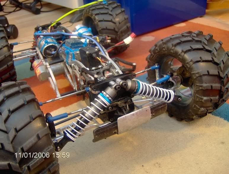

Well because the shocks are so long, I've had to do some custom mounting. The only way to mount them without increasing weight too much or mess up the CG was to custom-mount them like this:
...which probably explains why the damping feels so stiff with 70WT. But hopefully with the lighter oil, it will be better, and it should be quite progressive with the shallow angle. The rear arms are longer, so the shocks are positioned further out. The springs seem fine too, the whites look to be just right at the front with "arms level" ride-height. I haven't been able to mount the rears yet as I needed to orer some more long hinge-pins.I just hope the force of the shocks won't bend them!

Yeah it is out by the wheel. It looks awesome though. Well I hope it works out for you.

Well, I've found this shock-mounting style to work better than using separate shock towers (my old shocks were mounted in a similar way). It's lighter, gives a lower centre of gravity and provides very nearly as much travel as a normal shock tower setup. Also there's the cost. I had designed some towers (in a similar style to the chassis) which I was going to put into CAD and then get CNC-cut...and although this wouldn't be expensive (around £40 all told), money is pretty tight about now. :(
I'll see how the system performs, if the new shock layout cause issues then I might go to more conventional towers. :)
