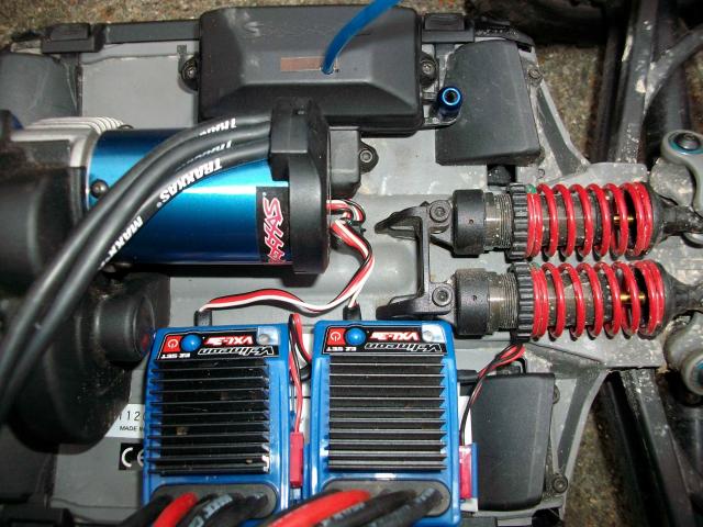

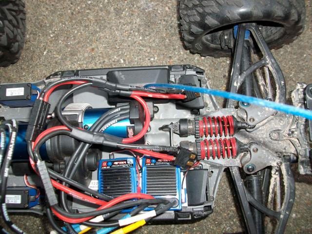

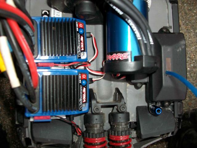

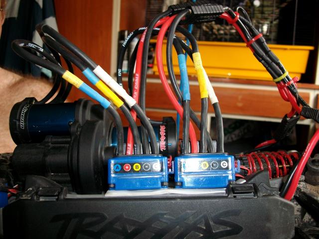

Sorry but something is obviously wrong with either the wiring or the guide - Please could you post up detailed pics.
We're kind of guessing with the info that you have provided. Regards

Hi, there the best i could do as the hex set were in my dads car from yesterdays bash so couldnt get the rx cover off. Hope this helps a bit more
cheers Ant

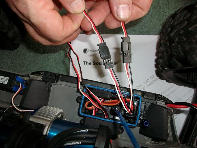

04.06.2009, 02:32 PM
Sorry it is the rx I really need to see...
Things to check...
1) Both ESC leads go to the throttle connection in the ESC via Y servo lead
2) Only 1 of the two ESC's red servi wire connects to the RX (either cut one of the red wires on the branches of the y lead or remove red wire from ESC plug
3) Check direction of rotation on motors to ensure both are powering the spur in the same direction
Despite the birds nest it creates it is a simple enough setup. rgds
bigdaddy1249
04.06.2009, 03:36 PM
Ah, our guide didnt say anything about cutting one of the red wires from the ESC, i presume thats to disable one of the BECs??
04.06.2009, 03:51 PM
Yes It might not be liking get back voltage... You don't have to cut just remove from clip with screwdriver and tape...
PS Tripple check both motors rotating correctly... :)

Hi, we tried disconnecting the red wire from one of the ESC and it didnt make an improvement, it also meant that the ESCs werent synced as we had to urn both on individually. The ESCs LEDs seem to flash really randomly, not in sync when the throttle is pressed, is this normal. There the pics from the reciever box, with the Y lead and bits.
thanks
Ant

Andrew32
04.10.2009, 09:42 AM
unplug everrything and start from scratch,
1. Your batteries in parallel?
2. Y harness. If you can, try switching the leads and rule out bad connection Example, if (esc,yharness branch) ESC1-1 and ESC2-2 and ESC1 works. Try ESC1-2 and ESC2-1. If ESC2 works, your harness is fine. IF it dont harness is bad.
3. Do both respond to calibration?
3. wire everthing BUT the motor and see if both LEDs respond.

Looking at his pictures, yes he is using a parallel harness that send the voltage to both escs, known as the "UNSLOW" harness.

Q. Do the motors work at all when they arent meshed to the spur?
I cant think why it wont work, it all seems wired up correctly.
Do me a favour- remove one esc from the Y-harness and try them individually from there- swap them over too, to check it isnt the Y harnes causing issues (since they work fine individually).
04.10.2009, 12:26 PM
I would simply remove the pinions from both motors and watch how they act. Just don't run WOT or for very long unloaded.
