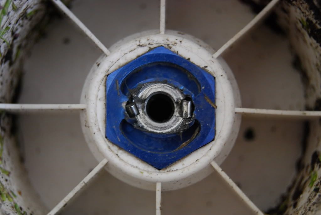

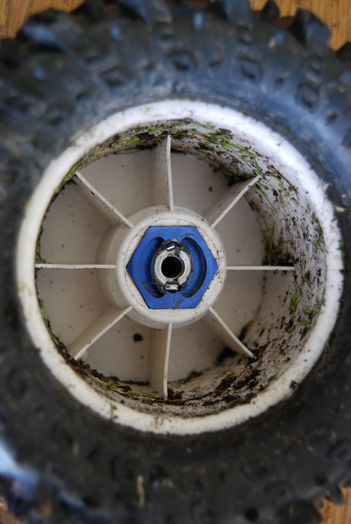

I have spent quite a bit on my E-revo drietrain, RCM hybrids coupled with KD cebter dogbones and MIP 1665 cvd's front and rear. all of this has led to a new weak spot, the rive pins in my 23mm hex's as well as the hex's themselves.
I have broken 5 or 6 of these since upgrading the rest of my drivetrain, only when i started to use ground down allen wrenches for my hexes did it stop, and even then i haven't had too many packs on them. Not too mention the
23mm hexes, they aren't that cheap to replace.
As for the rest of my setup, i would recommend all of the parts to anyone looking to stop replacing driveshafts and diffs!

That is cool damage, not fun for you but it's cool the way that pin just sheered off from both sides and the tips stayed right there wedged in the hexes.

yeah, this has happened several times and its getting annoying. plus all my Hexes are getting destroyed!!!
