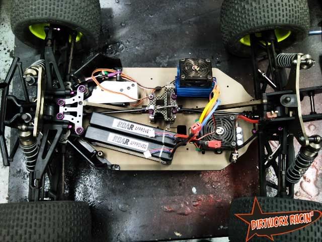

Hi guy's..New to the forum and thought i'd share my latest creation!Swapped this roller pro kit for a savage 25.Was in perfect condition and only used at one NATS last year..
Running 80amp EZrun combo with 3665 2300kv motor.Using Intellect 4600mah 20c lipo's..Had all of this in my e-savage and was just to powerful and got fed up with snapping shafts and diffs.E-savage RTR was round 4.45kg and the truggy is just over 4.3kg.So its light!In my e-savage with this setup temps was round 50-80deg F on ESC and 70-100 deg F on the motor depending on conditions and air temp.So it ran nice and cool so should work just fine here!

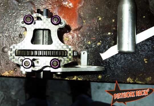

Mock up.

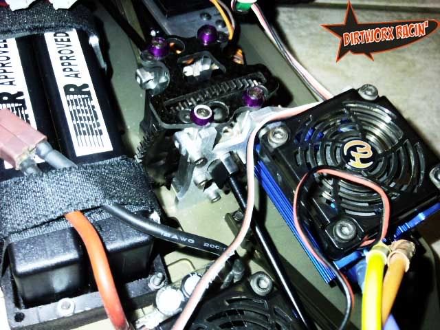

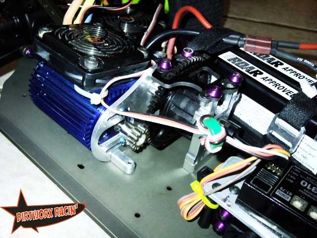

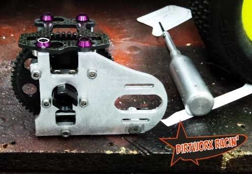

Custom motor mount.

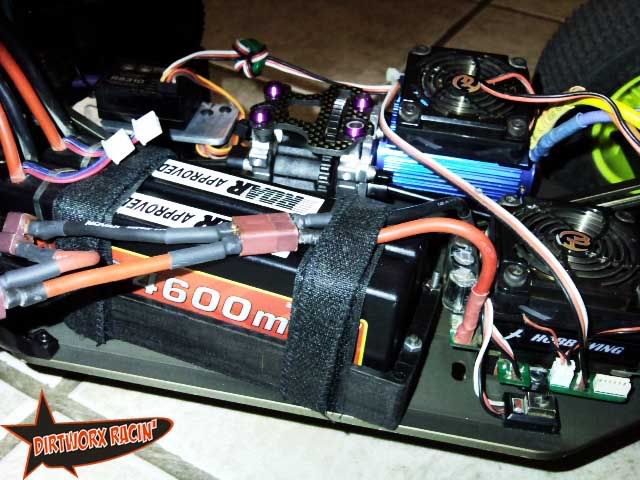

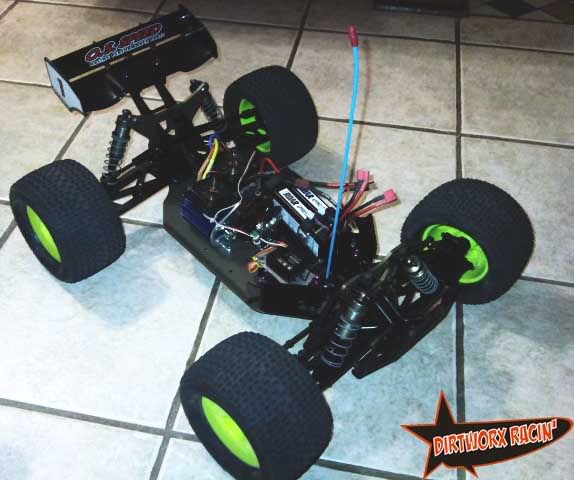

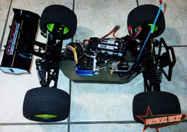

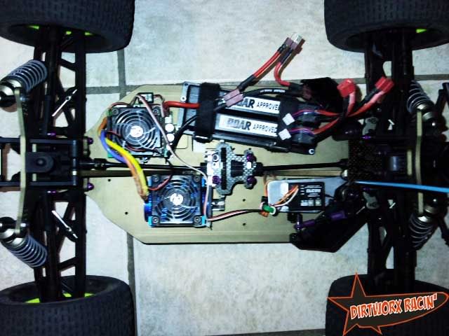

Everything fitted.Wiring still a mess but its sorted now.
