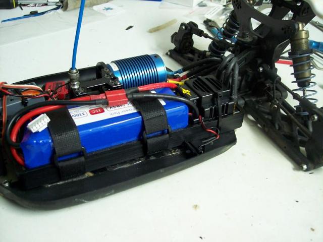

Well here is my 808.
-Rc-m battery/mmm tray
-Rc-m 808 mount
-Neu 1512 3d/f
-Hyperion G3 5s 3300 35c
-Airtronics 94360 servo (.125tq @ .07speed)
-MMM with deans wire and 4mm plugs (i hate the 6.5s)
weighs in at 3,184 grams (or 7 pounds and .3 ounces) RTR with JC body and Crimefighters all around.... its pretty light should run for about 12 minutes....
Highest point of the car (not including the wires) is the MMM case and next is the motor.

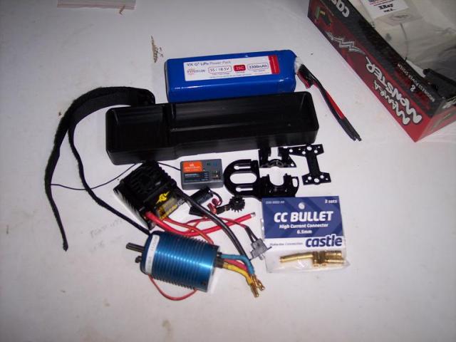

the 1st pic is it with the big bulky loaner setup out of my truggy using some old protek 5s (JC body barely fit)
2nd pic is the goodies that came in
and then the rest are it finished
cant wait to race it tomorrow.

I love the tray, awesome idea

its the same as the one used on Josh's mp9 it take a 140x44 battery and the MMM just slips right in there and has a groove cut down the middle to route the wire..

That is a nice light weight set up... I like it!

It ran great today at the race. its been a long time since i ran buggy (about a year) so it took me most of the day to get back in the swing of things with the buggy, but i was turned out awesome i lost to josh with his mp9 by only 1/20th of a sec. we were rubbing wheels across the line, great race at the end, i waited for him twice during the race but id rather run a close second and have a good race than run off with it. all the same it was a blast.
Report:
i was geared 15/42 running crime figthers, motor was only 130-138 after 7-8 minutes of running (6 min races with 3-4 extra laps usually) battery never broke 105, MMM never broke 135.... very happy with the setup, and i only ran the pack to the cutoff 15.5v once at the end of the day and got right at 13 minutes so its got plenty of runtime for our 10 min mains...
