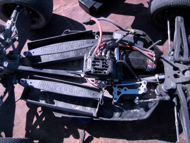

Here's my chassis set-up for my 6T (set up for 2 packs in a series). Yes, I had to dremmel the chassis a bit to make room for the center diff (super simple). I also put some washers underneath each center diff plate to raise the spur off the chassis a bit (before the spur was perfectly flush with the bottom of the chassis), a little too close for my liking.
The truck is perfectly balanced. Absolutely no adjustments needed in the air.
My buddy has the 2.0 T (nitro). It's a pretty dialed truck too. It's either him or me in the lead. Both trucks handle on rails and hold a straight line under acceleration.
