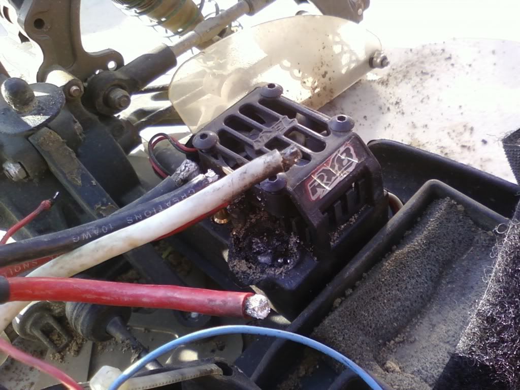

Then i Look to the esc to see if any of the wires were touching. I find this :
Two of the 5 posts are completely missing- esc is bricked, motor is bricked.
What caused this, I know that it failed, i want to know why.

I wonder maybe if you secure the wires better you'll have better luck? Maybe the stress on them gets them to short. Use 5 or 6 zip ties to secure your wires and see if that helps.

it looks like something shorted the bottom of the posts. I know that they used to put an alloy plate covered in stiky stuff inbetween the boards, but now they only put a small pice of fiberglass(?) that can brake off easly, mabey that broke loose??

It looks like you might have a cold solder issue. I don't know if anyone noticed in the close up pic, but I see there isn't enough solder on the wires and that might have caused the problem. I tin the crap out of my wires to make sure it will always have a strong bond after I'm done soldering.

I did, solder was damn near dripping off the wire, then heat up the post and the solder filled the little cup in the post.

When you get the ESC back from Tekin, tin the front of the motor and battery posts a good amount and do the same to the wires, add shrink tube to all the wires and solder to the front of the posts. I have 3 Tekin ESC and 2 of them have the wires soldered to the top and one I have solder the way I mentione above and seems way better. It offers much more surface area. I have a bug with my camera, but as soon as I fix the problem I'll take a picture to show you.
