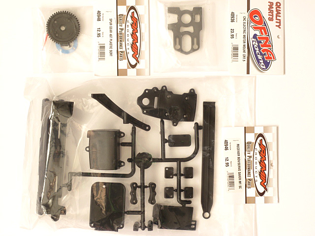

Hi All,
I've been checking out the Jammin SCRT-10 lately. Glad it uses so many CRT.5 parts as I love these little trucks and its great to know parts are going to be around for a while.
Looking at the manual today I saw something that gave me hope we may see an official Jammin CRT.5e release soon?
Manual is here...
http://ofna.com/pdf/34975-Jammin-SCRT.pdf
If you look on page 4 at the plastic tree, part number 40946. Its the new battery tray, ESC and Rx mount parts. Marked with a cross, as not used for the SCRT10, is a chassis brace that suits the new ESC mount and looks about the right size for a CRT.5?
What do you think???

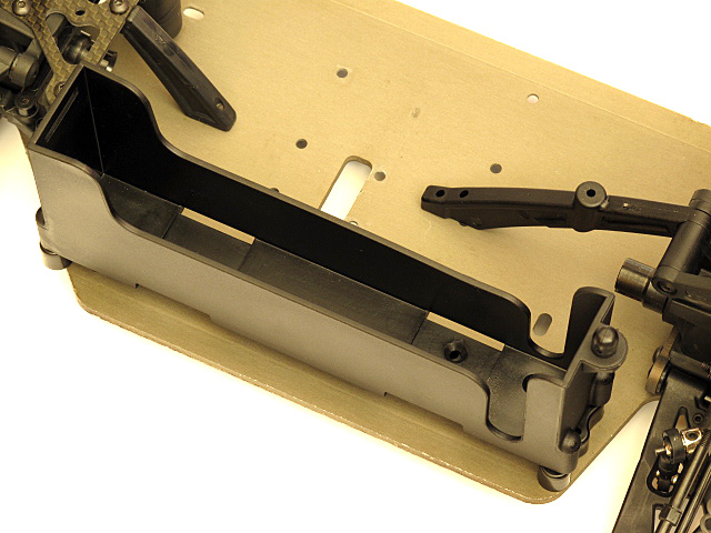

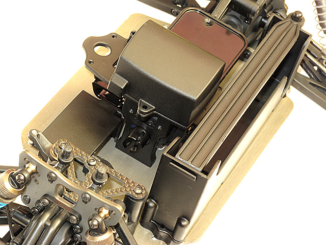

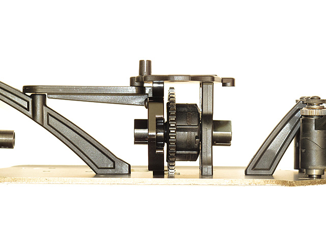

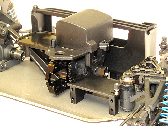

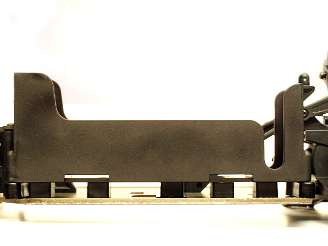

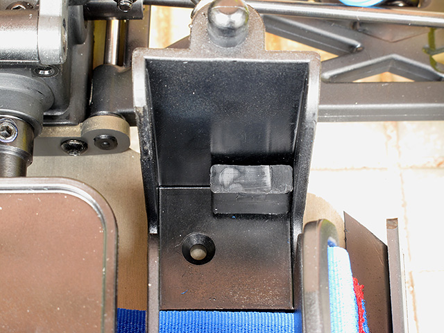

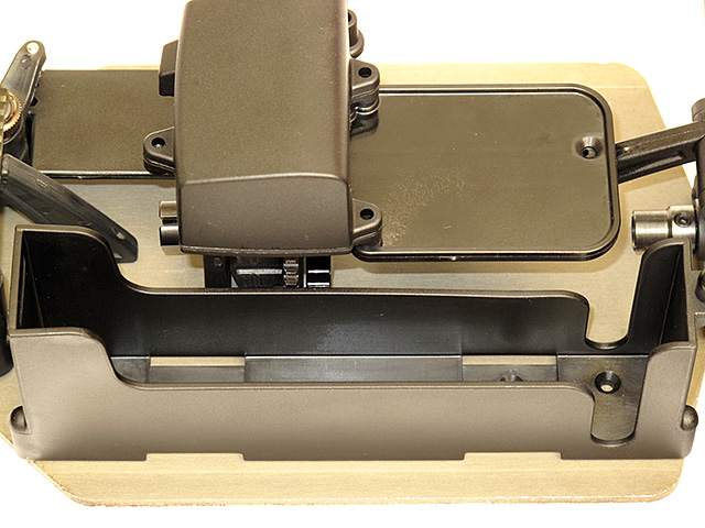

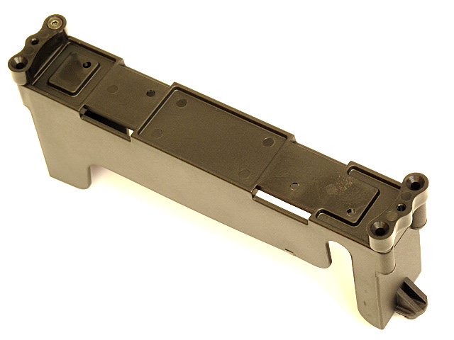

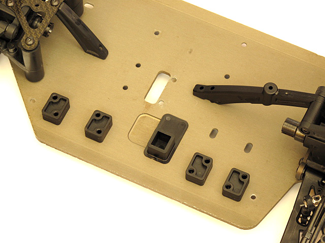

Excellent! Just received the parts from Nitrohouse.

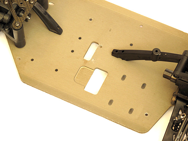

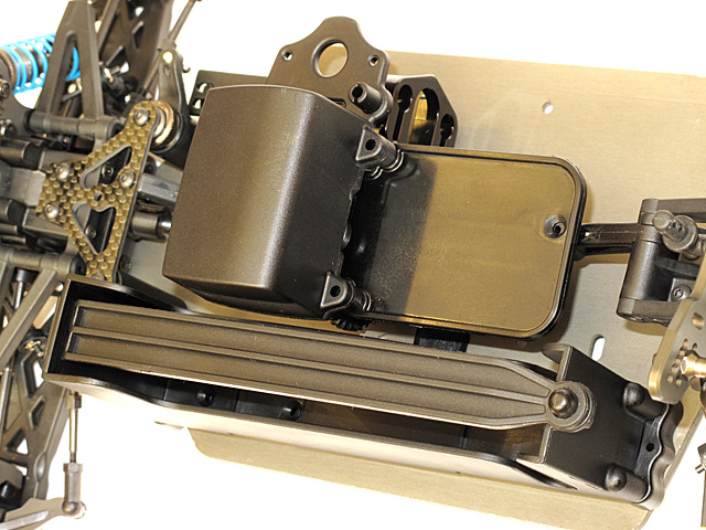

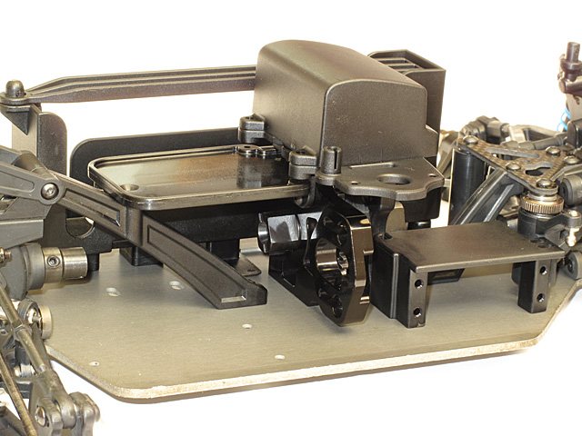

The parts definitely fit. Whats more those extra parts from the 40946 Batt tray moulding are actually to fit the conversion directly to an Ofna CRT.5 Extended chassis with no drilling required!
Clever, BUT... it raises the whole battery by about 7mm which will adversely affect COG.

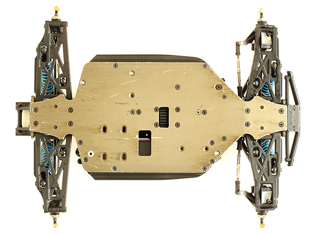

I was planning on mounting the batt tray straight to the chassis as per SCRT-10. There may be JUST enough room to drill the outside holes? see pics
The rear brace is indeed to fit the CRT.5. And the parts go together well for a tidy layout.
Hopefully Jammin will release it with a new chassis just a bit wider. And with mud guards!
Anyway, check out the pics. Parts are just sitting there for a rough fit at the moment.
So I'll think we'll soon see a CRT.5e from Jammin or maybe a conversion which is great as I really love the way it handles with the OFNA extended chassis and the stock wheels.
I'll keep posting pics as I get it together. (Still waiting on parts)
Cheers.
Name:	01 Parts.jpg
ID:	8323   Click image for larger version
Name:	02 Batt Tray Mounts.jpg
ID:	8324   Click image for larger version
Name:	03 Chassis Holes.jpg
Name:	04 Chassis Spacers.jpg
enlighten
01.11.2010, 10:24 PM

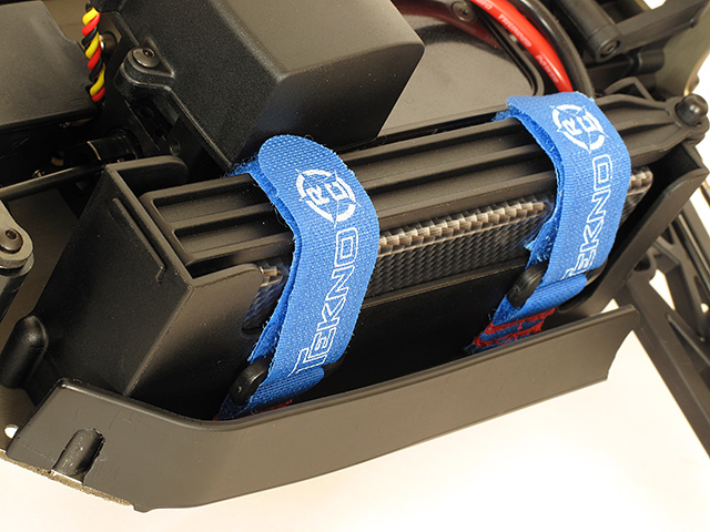

More Pics
Name:	05 Battery Tray Mounted.jpg
ID:	8328   Click image for larger version
Name:	06 Battery COG.jpg
ID:	8329   Click image for larger version
Name:	07 Top View.jpg

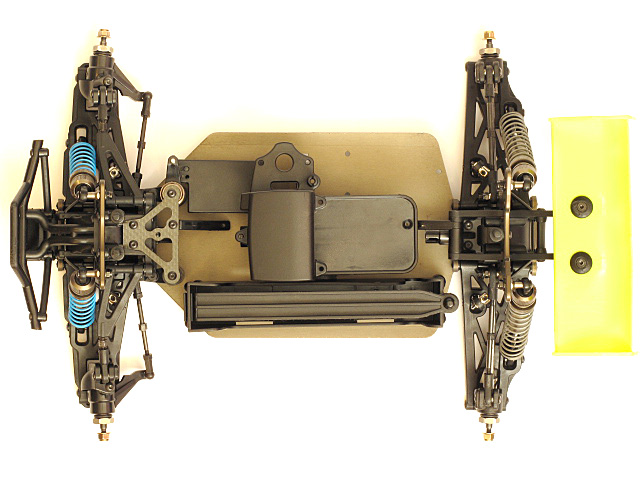

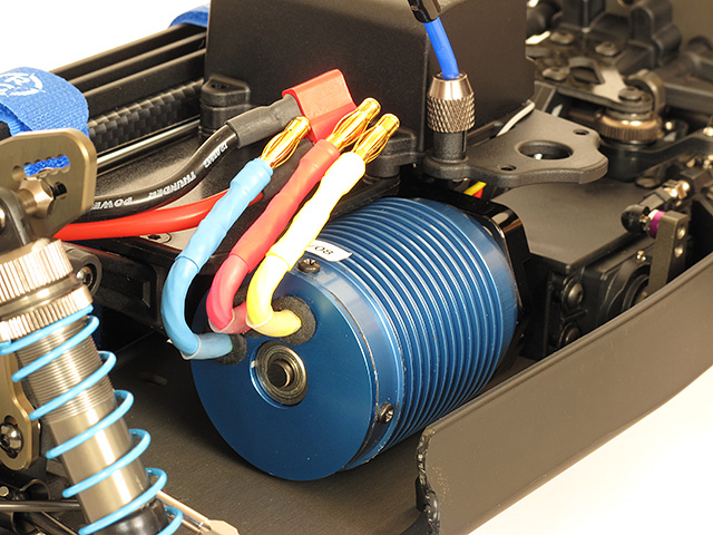

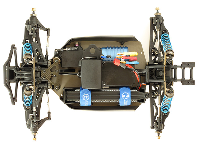

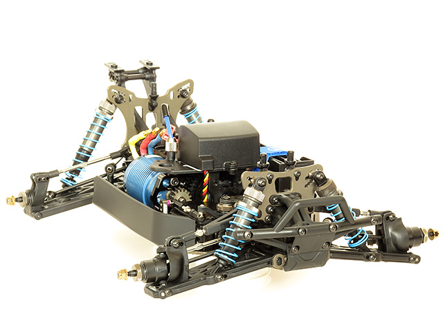

enlighten

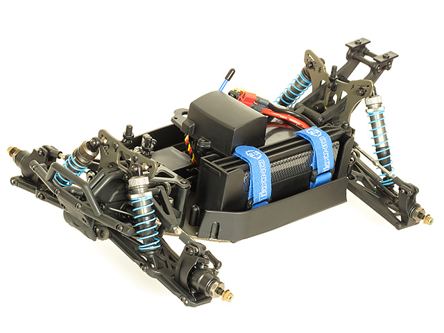

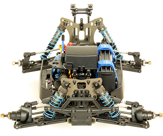

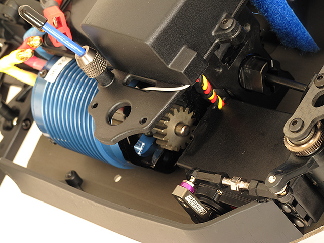

02.03.2010, 04:40 AM
Finally got it back together. Just waiting on the MMP now!
All went together smoothly. Just bolts together.
Mounted the battery tray on the chassis though. And also some Tekno mudgaurds.
I'll post some details soon.
Cheers.

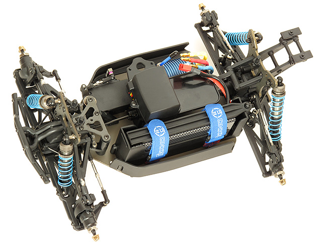

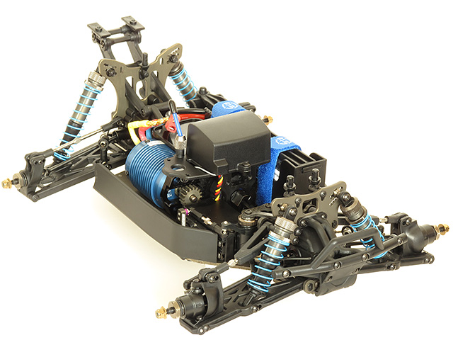

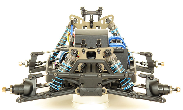

ID:	8436   Click image for larger version
ID:	8437   Click image for larger version
enlighten
More pics
ID:	8440   Click image for larger version
ID:	8441   Click image for larger version

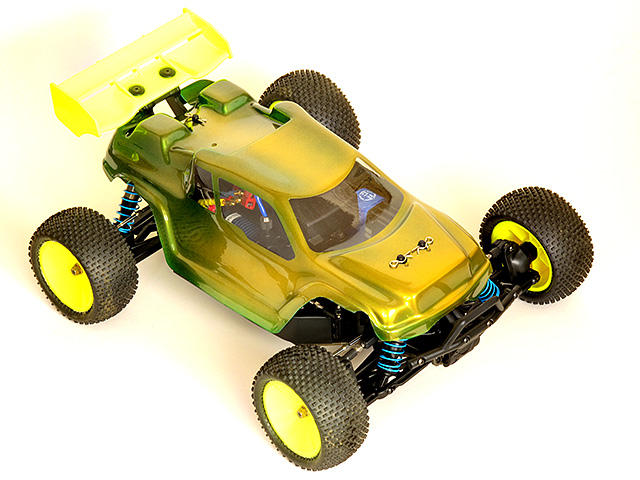

enlighten
02.03.2010, 04:44 AM
The Body is slightly 'toady' with the mudgaurds but overall it should work well. I won't cut the next body back so far in the front wheel arches.
Stuffed the paint up too. Was supposed to be green but was too heavy handed with the 'mist' of gold.
Cheers

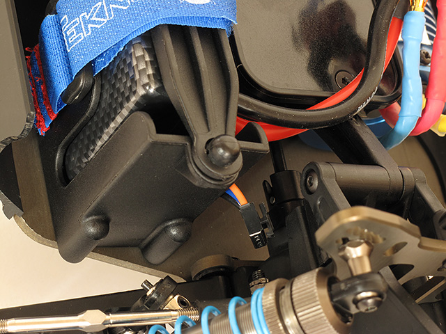

The MMP will go on the plate behind the receiver box, between the battery and motor. Bit high COG but whatever. They've done a great job with wiring with the new parts. Particularly, the servo wire is kept away from the spur nicely and the ESC wire will go directly into the back of the receiver box. It'll only be battery and motor wires exposed.
