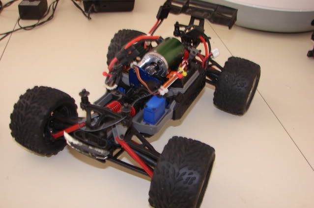

We did some pretty extensive testing using the 26mm motors, and the results were generally not pretty. Even the most conservative setups struggled, but were sometimes manageable. The 1/16th E-Revo and Slash fall into a gray area for our motor lineup. The 20mm and 26mm are too small, and the 540 cans don't fit the stock setup. I have seen a conversion that allows you to mount a 540 or 550 can, and the results are... interesting. They have a 5700kV on 3s. And my personal favorite, the Monster with a Neu 1515/1Y on...6s. I've seen a video of it doing well over 70mph. Although we at Castle do not recommend such craziness, it's still pretty freaking cool.
Those are extreme setups of course, but a Sidewinder with a 4600kV or 5700kV will provide much more torque and speed than the stock setup. You would need to upgrade the batteries a bit to support the bigger motor and additional weight. Some people are choosing to put in a Sidewinder, Mamba Max or Mamba Max Pro in place of the stock controller, but using the stock motor. This gives you all of the Castle Link functions, and of course the Castle support to back you up. :)

Stock motor is actually a ripper and works well with a Mamba Max on 3s / 4s
I was running it for months with no issues
Now have the Tenbol BB mount and the castle CMS36-4600 and it flies

fyi the 1717 doesnt fit the tenbol mount, i tried

The new 1409 series Neu's should fit they are a standard 36mm size
That will be my next motor if I get sick of the castle
For info those that are looking for motor options
The 4600kv geared 28/45 with good foams is good for
40 mph on 2s lipo
60 mph on 3s lipo
80 mph on 4s lipo
Cheers
You tried to fit a 1717 into a mini Revo??? You are one sick puppy.
