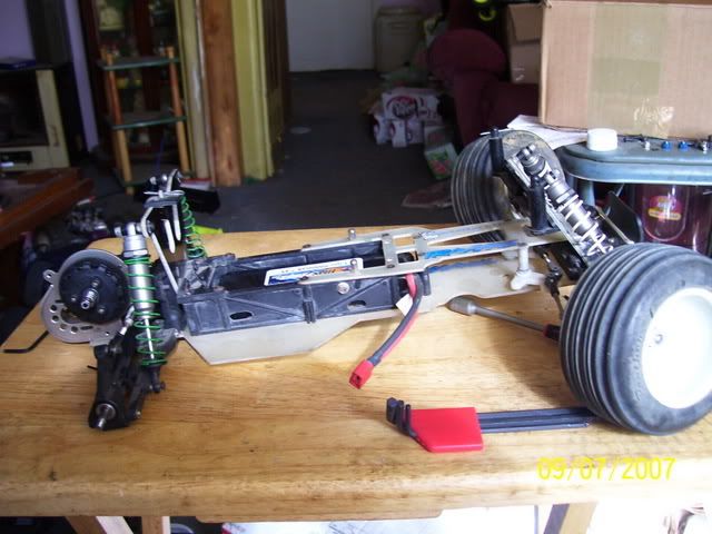

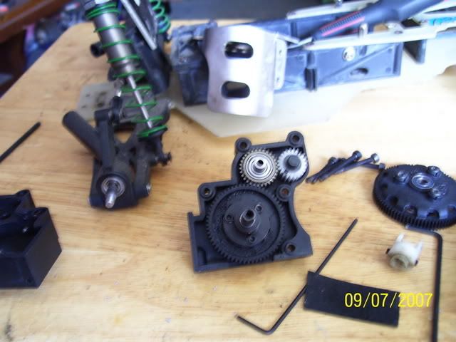

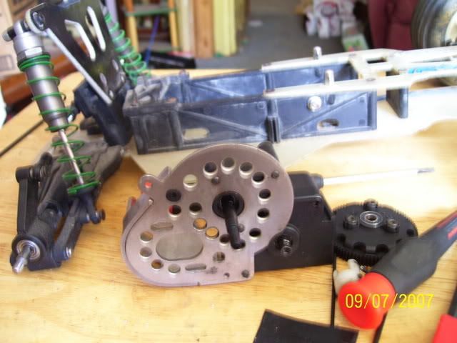

As Promised, here are the pics of what i am starting with. I will update with more pics, as i make changes.
First pic is tranny showing the delrin top gear and alumnium idler
[IMG][/IMG]
tranny assembled with XL/VXL top shaft
[IMG][/IMG]

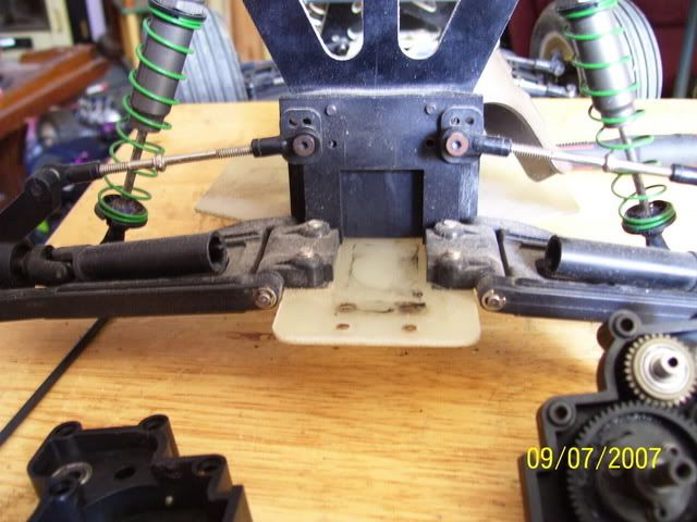

rear view showing the bulk and space where tranny sits
[IMG][/IMG]
side rear view showing where the bulk meets battery box
[IMG][/IMG]

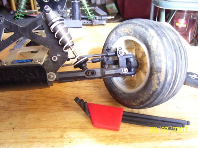

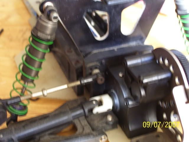

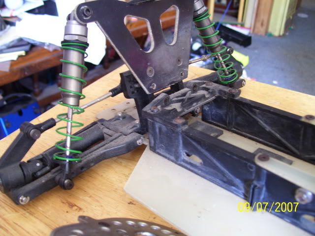

More pics,
tranny mounted side view
[IMG][/IMG]
rear showing where tranny and bulk key together
[IMG][/IMG]
pic of front suspension and steering, Look familar? this is where the Nitro rustler/Stampede steering came from
[IMG][/IMG]
I also plan to see, if the electric Rustler/ Stampede arms will improve stability without going too wide. The SRT uses the nitro geometry and arm length
