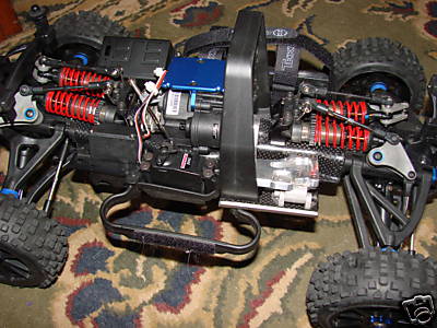

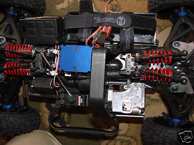

Here is a couple pics still have a ways to go

I think going with Mikes motor mount is a sensible option over the long run.
