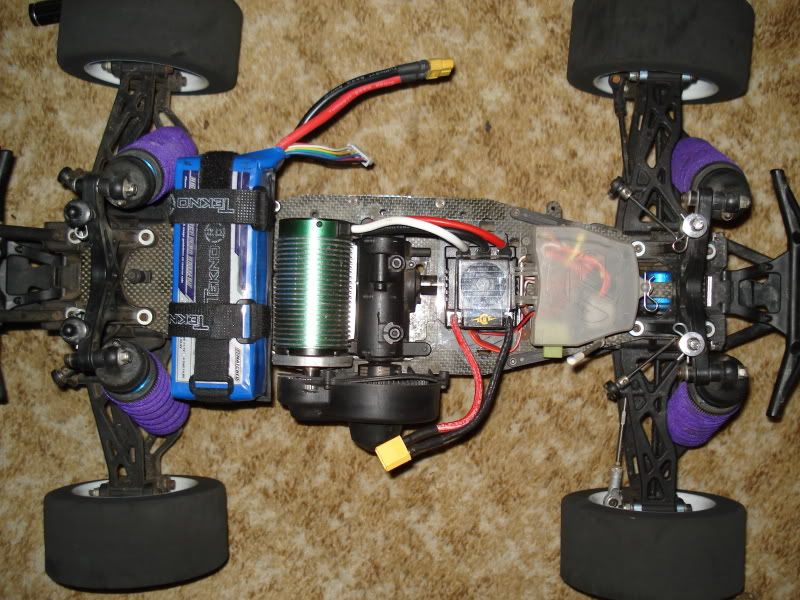

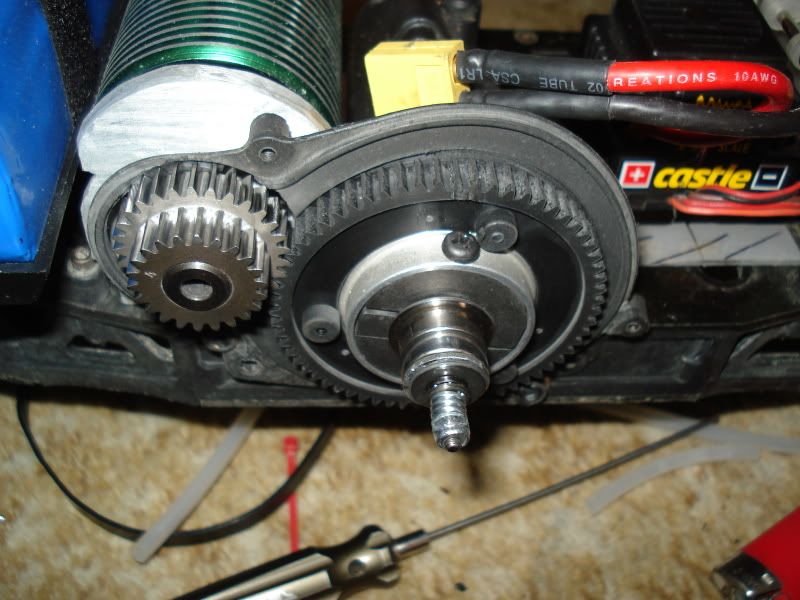

Here are a few pics of mine.

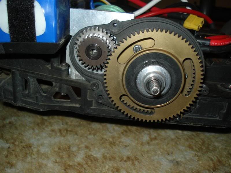

I managed a very simple cheap conversion. Then I bought the Losi Single Speed Conversion, which needs longer bolts to hold the gear & put nuts on the exposed threaded end. I had mine fall off. With nuts, no problem!
Now running a 34T pinion. This motor is the 1717 1580kv Castle motor, Castle Mamba Monster on 6S. The closest thing to it now is the XO-1 motor.
Also, I changed to motor brakes because I could not get it to stop or stop chewing through brake pads & discs. They would glow red in the night time!!
A little video on the beach with paddles.

Well, you need to gear appropriately for your motor & wheels too.
I originally built this as a racer with a .32 engine, then converted it years later.
So, it was already sporting the FOC kit with a gear flip which increases speed. I have also changed the bevel gears to the higher ratio for more speed since being converted.
I'm using a motor much bigger than yours because I wanted the torque to be able to gear up for insane speeds. Last clocked chasing with a car at 100km/h at 3/4 throttle (still to try the 34T pinion on the freeway). My motor gets to about 65-70 degrees Celsius, not sure of Fahrenheit, after a full pack doing WOT runs. ESC has a fan & it rarely turns on. Unless it's a 30+ degree day.
If I gear down it will flip constantly, but, this is still a wheelie king!!
Another thing, I soon discovered that my truck was mostly starting off in 2nd gear anyway as the torque produced was overriding the two-speed clutches instantly!
This next video is running my original setup (See pic) which was a +4 over stock on metal gears which explains the ringing noise in the camera.

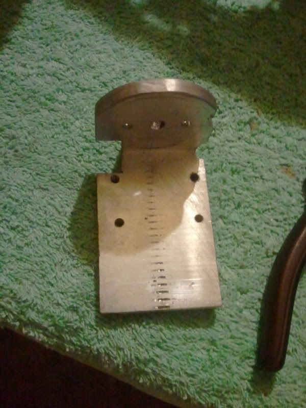

yea, singlespeed I think its going to be first thing I do with it. I don't care for the fine design kit, I just got the parts used so I have them. the battery mount sucks, it uses rubber bands which I have to credit FD did send me some for free last week when one snapped but they are awefully tough to go over 6s battery.
I noticed the back center drive shaft is a little bent. diffs seem good. checked the gear mesh earlier and it looked okay. i'm gonna rip the tranny down to do the forward only once I get new esc anyway.
I'll have to get this kit soon I think, that fine design motor mount isn't the best, screws it comes with would make you laugh, i'm afraid to take them out as I know they will never go back in again without stripping.
