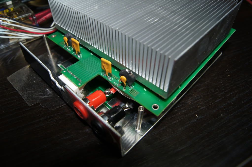

I thought I blew the charger, by messing up the balancing wires while the charger was active. I didn't blew fuses, but did hear some popping. Long story short, I opened the bad boy and saw that the current limiter was popped. I was only able to charge through the balancing cables. Digikey to the rescue and all is well again. This time I bought me some parallel balancing adapters to prevent me from goofing off again.

I was in a rush with getting into the house, but wanted to charge my batteries for the next day. So I charged one pack and when it finished I just unplugged the balancing wires and power cable. My mistake was not hitting the stop button when the charging was done. The charger was still active when I plugged in the next set of batteries, which isn't a problem unless you plug them in wrong.

Thank you for the picture and detailed account of your experience.
What will you do next, in order to repair the damaged part? It may be a very low fee to send the charger back in to the manufacturer for a repair estimate, and or maybe this part could be processed under warranty. I do not know for sure. I also wonder if any aditional part or parts may have been damaged, beyond the one piece we can see in the picture. What are your thoughts about this at this point in time?

I've allready repaired the Powerlab. It would of taken more time and cost more for me to send it out to get repaired. With me ordering the parts from Digikey, I was only out of a high amp charger for a few days, instead of a few weeks.
