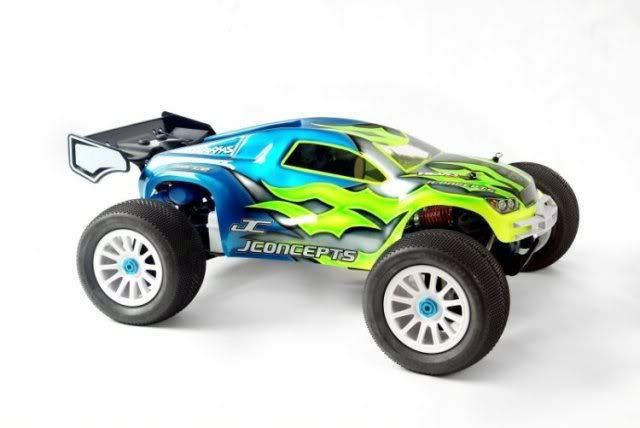

It between the desert rat and this one from JD Concepts "Tango" what do you think?
Do Revo bodies come with a hole already cut out of the engine?
